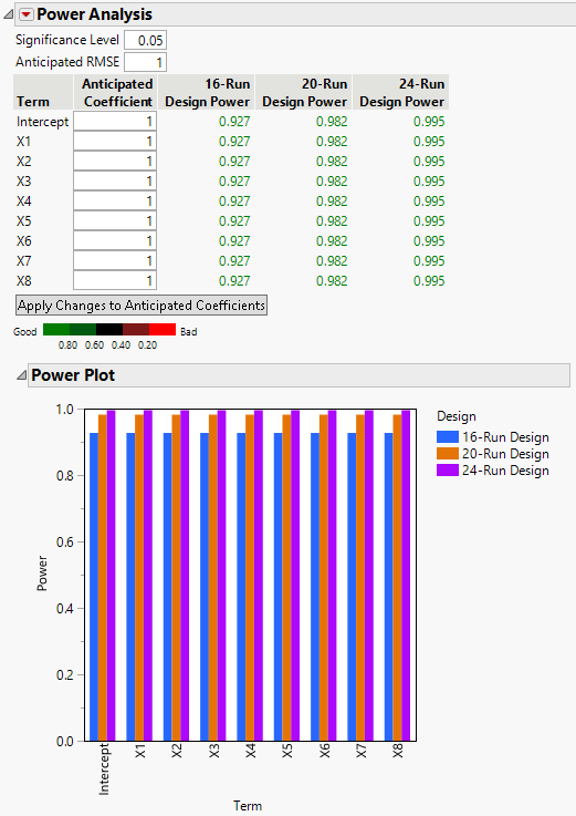

Figure 17.8 Power Analysis Comparison
All three designs have high power for detecting main effects if the coefficients are on the order of the Anticipated RMSE.

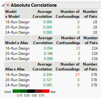

Figure 17.11 Absolute Correlations Comparison
The Absolute Correlations table summarizes the information shown in the Color Maps on Correlations. Recall that the model for all three designs consists of only main effects and the Alias Matrix contains two-factor interactions.
For the 16-run design, the Model x Alias portion of the table indicates that there are 21 confoundings of main effects with two-factor interactions. The Alias x Alias portion indicates that there are 21 confoundings of two-factor interactions.
