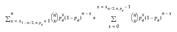

for a two-sided alternative:
where xq,n,p is the qth quantile of a binomial distribution with n trials and probability p.

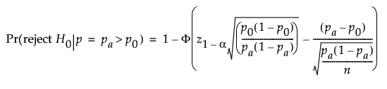

For a one-sided, higher alternative:

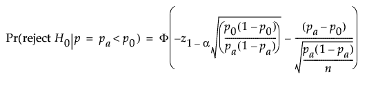

For a one-sided, lower alternative:

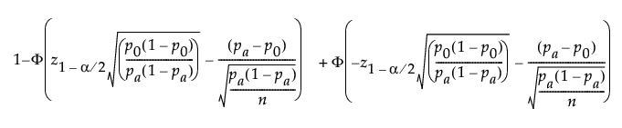

For a two-sided alternative:
