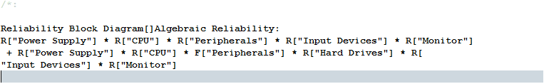

The Log window displays the formula for the Algebraic Reliability of the selected block diagram.
Figure 12.29 Algebraic Reliability in Log Window
Note: Reliability formulas use “R” to represent a component’s reliability and “F” to represent probability of a component’s failure.
