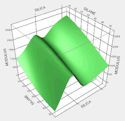

A surface plot is a three-dimensional plot with one or more dependent variables represented by a smooth surface. You can display up to four dependent variables on the same surface plot.
JMP produces surface plots in the following two situations:
• The Surface Plot platform creates a stand-alone report that contains a surface plot for formulas. The formulas can be formula columns in your data table or mathematical formulas that do not involve any data points.
• The Surface Profiler option in many model fitting platforms produces a surface plot for the fitted model in the existing platform report.
Figure 5.1 Example of a Surface Plot
