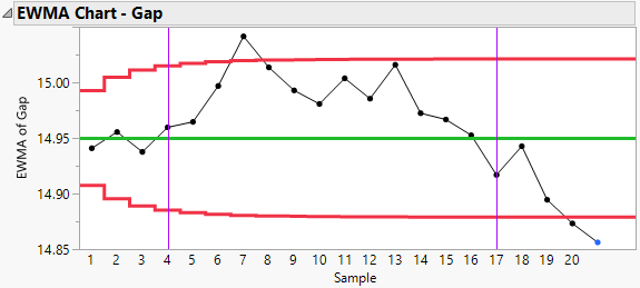

Figure 11.6 Shift Lines Example
Shift Lines Example
In this example, the point for sample 7 is above the upper limit. Looking back from sample 7, the most recent point below the Target line is sample 3. Therefore, sample 4 is the first point above the Target line since the most recent point below the Target line and is denoted as the start of the positive shift.
Similarly, the point for sample 20 is below the lower limit and the most recent point above the Target line is sample 16. Therefore, sample 17 is denoted as the start of the negative shift.
