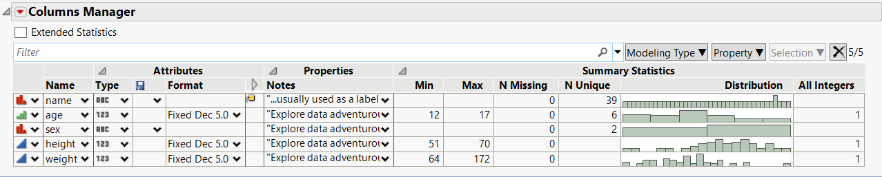

Figure 5.5 The Columns Manager Window
The Columns Manager window contains the following information:
