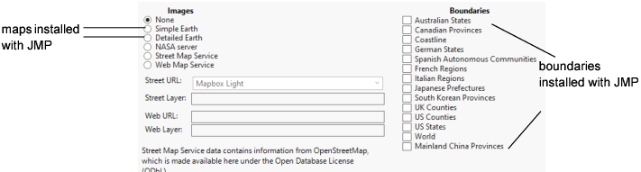

The Background Map window shows two columns of choices: Images and Boundaries. On the left of the window that you can select from two built-in map images, or you can connect to a Web Map Service to retrieve a background image. On the right side of the window, you can select political boundaries for a number of regions.
Figure 12.12 Example of Background Map Options
The following Background Map options are available:
Images
None
Removes the background map that you selected in the Images column.
Simple Earth
Shows a map of basic terrain. For examples, run the associated scripts in these sample data tables: SAS Offices.jmp and Aircraft Incidents.jmp.
Detailed Earth
Shows a high-resolution map with detailed terrain.
NASA Server
Shows a map from the NASA server. Requires an Internet connection.
Street Map Service
Shows a map with an appropriate amount of detail based on the display’s zoom level. This enables you to zoom down to the street level. For example, run the associated script in the sample data table SAS Offices.jmp.
Web Map Service
Shows a map from the Uniform Resource Locator (URL) and the layer that you specify. Requires an Internet connection.
Boundaries
Boundaries for various regions
Shows borders for the map regions, such as Canadian provinces, U.S. counties, U.S. States, and world countries. The list varies based on your location. The maps that you created from Esri shapefiles are also listed here.
