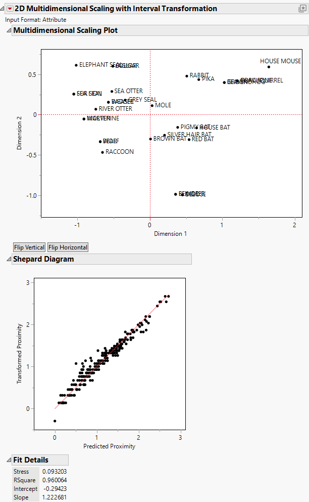

Use MDS to explore the similarities of 32 mammals based on their teeth. An interval transformation is used to illustrate the output from that transformation. The data do have an ordering that has a meaning (four teeth are twice as many as two teeth). One might explore other transformations such as the ordinal transformation.

Figure 10.6 Multidimensional Scaling ReportĀ
The Shepard Diagram and the Fit Details indicate that the MDS Plot is a good representation of similarities of animals due to similarities in their teeth. The Stress statistics of 0.093 is low and the R2 fit of the transformed versus predicted proximities is high at 0.96. In addition, the Fit Details provides the intercept and slope for the transformation of the actual proximities.
