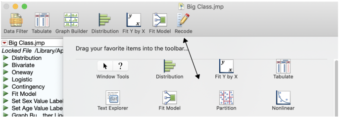

To add, remove, or rearrange toolbar icons
1. Open the type of window whose toolbar you want to customize.
2. Select View > Customize Toolbar.
A window appears that shows icons relevant to the current type of window.
3. Do any of the following:
– To add an icon to the toolbar, drag the icon from the window onto the toolbar.
– To move an icon on the toolbar, drag the icon to its new location onto the toolbar.
– To remove an icon from the toolbar, drag the icon from the toolbar onto the window.

Figure 14.5 Add, Rearrange, and Remove Toolbar Buttons on macOS
