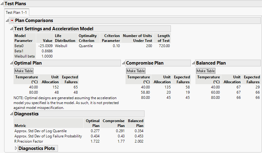

There are three test plans presented: an optimal, a compromise, and a balanced plan. The optimal design allocates 152 units to the low temperature and 48 units to the high temperature. The compromise and balanced plans allocate units across three temperature settings.
Note: The compromise plan allocates units to a temperature setting of 58.80. In practice, you would select a temperature as close to that value as possible within the precision of your temperature chamber.
Figure 22.2 Test Plans and Diagnostics
Use the diagnostics to compare the plans. For this acceleration model, all three plans have similar metrics. Select the balanced plan if you are able to run three temperature settings with an even distribution of units. Otherwise, select between the compromise and optimal plan based on test logistics.
Use the diagnostic plots to explore the sensitivity of the test plans to changes in the assumptions and to compare the three plans. The distribution profiler gives the expected failure probability as a function of temperature and time for each of the plans. Explore how the failure probability changes for each plan across the time and temperature ranges. As observed in the diagnostics, the profilers also demonstrate that there is little difference between plan types. The size of the intervals around the estimates gives a sense of the anticipated level of uncertainty for your test plan.
