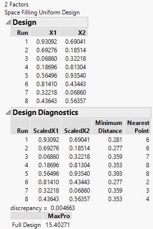

Figure 21.10 Factor Settings and Diagnostics for Uniform Space-Filling Designs with Eight Runs
The emphasis of the Uniform design method is not to spread out the points but to distribute the points for each factor uniformly. The minimum distances between pairs of points vary substantially. Use distributions to visualize the spread of points within a factor.

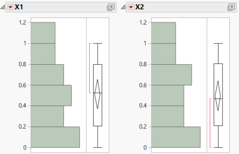

A Uniform design does not guarantee even spacing of the factor levels. However, running a distribution on each factor (use Analyze > Distribution) shows flat histograms.
Figure 21.11 Histograms for Each Factor
