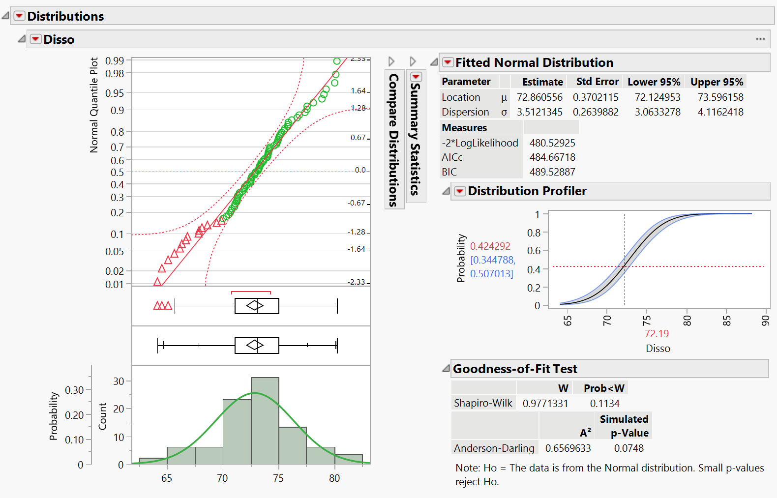

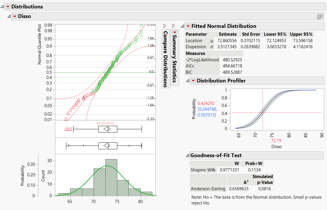

4. Click the Platform Preset button Image shown here in the Disso menu bar.
5. Select Sample Presets > Check Normality.
Figure 10.2 The Distribution report updated by a sample Platform Preset.
The sample Platform Preset minimizes the Summary Statistics and adds the following to the report window: a Normal Quantile Plot of the Disso variable, the Fitted Normal Distribution report, a Distribution Profiler, and a Goodness-of-Fit Test.
Because the normal quantile plot approximates a straight diagonal line, the Disso variable appears to be normally distributed.
