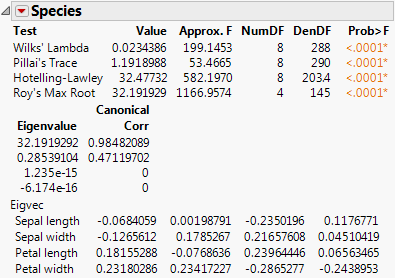

9. Click the Species red triangle and select Test Details.
The eigenvalues, eigenvectors, and canonical correlations appear.
Figure 10.11 Test DetailsĀ
Test Details
