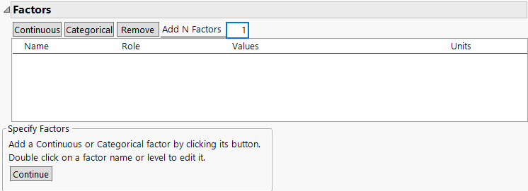

Add definitive design factors in the Factors section.
Figure 8.7 Factors
Factors
The factors section contains the following buttons.
Continuous
Enters the number of continuous factors specified in Add N Factors.
Categorical
Enters the number of nominal factors specified in Add N Factors.
Remove
Removes the selected factors.
Add N Factors
Adds multiple factors of a given type. Enter the number of factors to add and click Continuous or Categorical. Repeat Add N Factors to add multiple factors of different types.
Tip: When you have completed your Factors panel, select Save Factors from the red triangle menu. This saves the factor names and values in a data table that you can later reload. See Definitive Screening Design Options.
The Factors section contains the following columns:
Name
The name of the factor. When added, a factor is given a default name of X1, X2, and so on. To change this name, double-click it and enter the desired name.
Role
Specifies the Design Role of the factor. The Design Role column property for the factor is saved to the data table. This property ensures that the factor type is modeled appropriately.
Values
The experimental settings for the factors. To insert Values, click the default values and enter the desired values.
