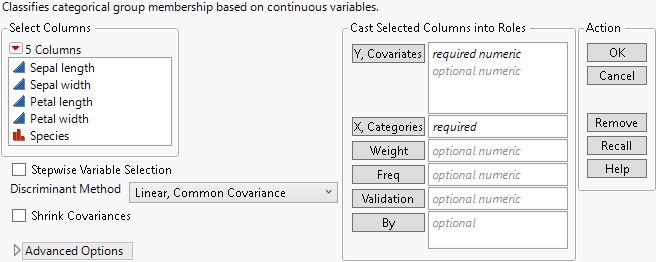

Launch the Discriminant platform by selecting Analyze > Multivariate Methods > Discriminant.
Figure 5.3 Discriminant Launch Window for Iris.jmp
Note: The Validation button appears in JMP Pro only. In JMP, you can define a validation set using excluded rows. See Validation in JMP and JMP Pro.
