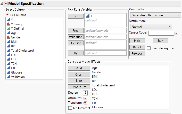

Launch the Generalized Regression personality by selecting Analyze > Fit Model, entering one or more columns for Y, and selecting Generalized Regression from the Personality menu.
Figure 6.4 Fit Model Launch Window with Generalized Regression Selected
