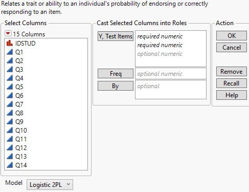

Launch the Item Analysis platform by selecting Analyze > Multivariate Methods > Item Analysis.
Figure 12.4 Item Analysis Launch Window
Y, Test Items
Assigns two or more columns to be analyzed. The columns must be numeric, continuous, and contain only 0s and 1s.
Tip: Use Cols > Recode if you need to recode your data to 0s and 1s. See “Recode Data in a Column” in Using JMP.
Freq
Assigns a frequency variable to this role. This is useful if your data are summarized.
By
Produces a separate report for each level of the By variable. If more than one By variable is assigned, a separate report is produced for each possible combination of the levels of the By variable.
Model
Specifies the desired model from the following options:
Logistic 2PL
The 2-parameter logistic model.
Logistic 3PL
The 3-parameter logistic model.
Logistic 1PL
The 1-parameter logistic model with a Rasch parameterization.
