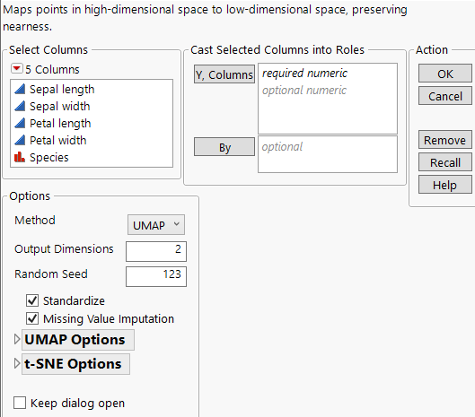

Launch the Multivariate Embedding PlatformLaunch the Multivariate Embedding platform by selecting Analyze > Multivariate Methods > Multivariate Embedding.
Figure 11.3 Multivariate Embedding Launch Window
For more information about the options in the Select Columns red triangle menu, see “Column Filter Menu” in Using JMP. The Multivariate Embedding launch window contains the following options:
