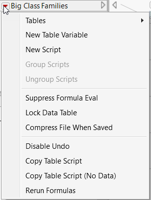

To embed a data table in a journal
To avoid linking to an external data table, copy the data table into a script and place it in the journal. The advantage is that other users always have access to your data, and you do not need to edit links. The disadvantage is that, if you want to edit the data, you must edit the script.
1. In the data table, click the red triangle next to the data table name and select Copy Table Script.
Figure 11.37 Copying a Table Script
