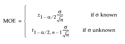

Confidence Intervals
The margin of error (MOE) for a two-sided confidence intervals is calculated as follows:
Equation shown here

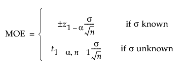

The MOE for a one-sided confidence interval is calculated as follows:
Equation shown here
where:
α is the significance level
z1-α is the (1 - α)th quantile of the normal distribution
t1-α,ν is the (1 - α)th quantile of the central t-distribution with ν degrees of freedom
σ is the assumed population standard deviation
n is the number of samples.
