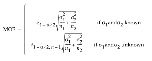

The margin of error (MOE) is calculated as follows:
Equation shown here
When σ1 and σ2 are unknown, the MOE is calculated as follows:
Equation shown here

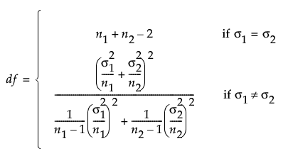

where
Equation shown here
When σ is known, the MOE is calculated as follows:
Equation shown here
