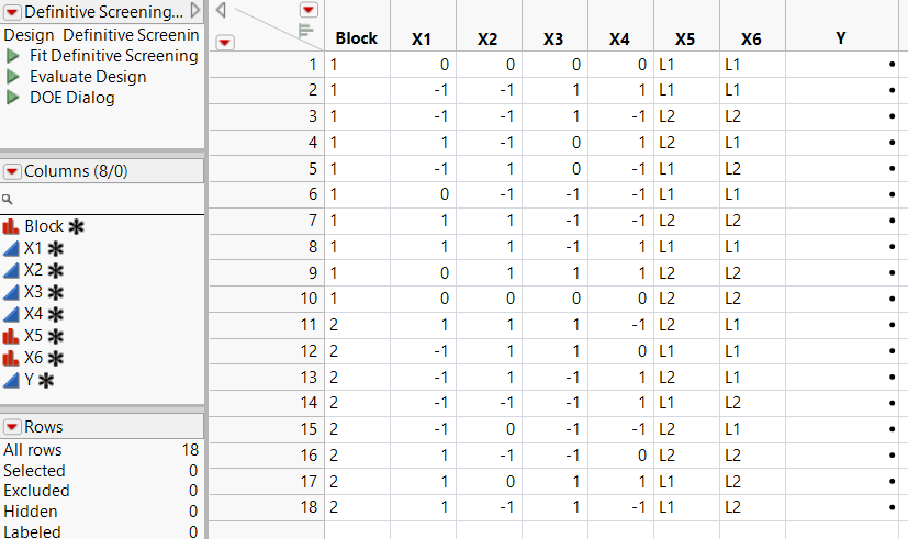

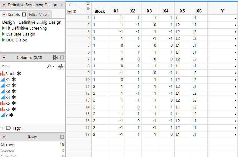

Make Table
Click Make Table to construct the Definitive Screening Design data table.
In the Definitive Screening Design table, the Table panel (in the upper left) contains the following scripts. To run a script, click the green triangle next to the script name.
Fit Definitive Screening
Runs the DOE > Definitive Screening > Fit Definitive Screening platform. See “The Fit Definitive Screening Platform”.
Evaluate Design
Runs the DOE > Design Diagnostics > Evaluate Design platform. See “Evaluate Designs”.
DOE Dialog
Re-creates the Definitive Screening Design window that you used to generate the design table.
Figure 8.9 Definitive Screening Design Table Showing Scripts
