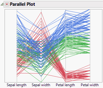

Using parallel plots, you can visualize each cell in a data table. Parallel plots draw connected line segments that represent each row in a data table. Parallel plots were initially developed by Inselberg (1985) and later popularized by Wegman (1990).
Figure 7.1 Example of a Parallel PlotĀ
