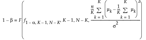

The power calculations for testing differences among means from multiple groups assumes equal standard deviations for each group. Power calculations are based on the standard F test. The power (1-β) is computed based on the test specification.
For group means:
For between-groups:
For maximum difference, worst case:
For maximum difference, all but one:
where
F(q, df1, df2, λ) is a non-central F-distribution with noncentrality parameter λ.
K is the number of groups
n is the number of samples within each group (assumed equal for all groups)
N = nK
μk is the assumed mean for group k
σ2BG is the sum of the squared differences between the group means and the grand mean scaled by 1/(K-1)
δWC is the difference between the largest and smallest group means
δABO is the difference between one mean and the average of all other means
σ2 is the within-group variance (assumed equal for all groups)
α is the significance level.
