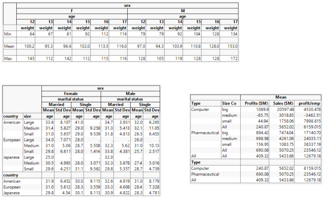

Figure 9.10 Tabulate Output
Tabulate Output
