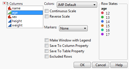

3. In the window that appears, highlight the column whose values you want to color or mark. A preview of the legend is shown on the right.
Figure 9.25 Adding a Row Legend
Adding a Row Legend
4. Refine your row legend using the following options:
