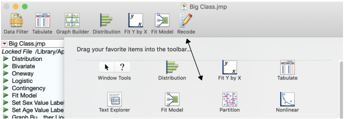

To add, remove, or rearrange toolbar icons
1. Open the type of window whose toolbar you want to customize.
2. Select View > Customize Toolbar.
A window appears that shows icons relevant to the current type of window.
3. Do any of the following:
– To add an icon to the toolbar, drag the icon from the window onto the toolbar.
– To move an icon on the toolbar, drag the icon to its new location onto the toolbar.
– To remove an icon from the toolbar, drag the icon from the toolbar onto the window.
Your changes are applied to the current window and all open windows of the same type.
Figure 14.5 Add, Rearrange, and Remove Toolbar Buttons on macOS
4. Click Done.
