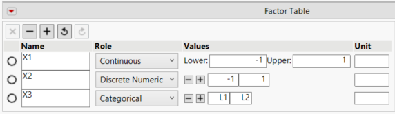

Factors
Factors are the variables or inputs that you control in your experiment. The Easy DOE platform supports continuous, categorical and discrete numeric factor types. The Factor Table updates as you add factors to your design. By default, the table contains one factor named X1 with the Role of Continuous. You must have at least two factors for your design. Add or modify factors using the Choices or the Factors Table sections.
Choices
Use the Role section in the Guided Mode to add a factor with a specified role. Click on the hints for additional information about each factor type. Click a button in the Role section to add a factor to the design:
Add a Continuous Factor
Adds one continuous factor to the design. A continuous factor can take any numeric value between the specified lower and upper limits.
Add a Discrete Numeric Factor
Adds one discrete numeric factor to the design. A discrete numeric factor is like a continuous factor, but it can be set only to the specified values.
Add a Categorical Factor
Adds one categorical factor to the design. A categorical factor can take on a specified number of categories, groups, or types.
Factor Table
Use the Factor Table to add or modify factors for your experiment.
Factor Buttons
Removes the selected factor.
Removes the last factor.
Adds a factor.
Undo last action.
Redo last action.
Name
The name of the factor. When added, a factor is given a default name. To change this name, click it and enter the desired name.
Role
Specifies the role of the factor. Factors roles are continuous, discrete numeric, or categorical. The role ensures that the factor is modeled appropriately once data is collected.
Values
The factor values section of the Factor Table enables you to set the experimental settings, or levels, for the factors. The factor value settings differ for each factor type. For continuous factors, enter the lower and upper limits to define the factor range. For discrete numeric factors, enter a value for each discrete level. For categorical factors, enter a value for each level. For discrete numeric and categorical factors, use the plus and minus buttons to adjust the number of levels. To update values, click the default values and enter the desired values.
Figure 7.10 Factor Values
Factor Values
Units
The experimental units for the factors. To insert Units, click and enter the appropriate units.
