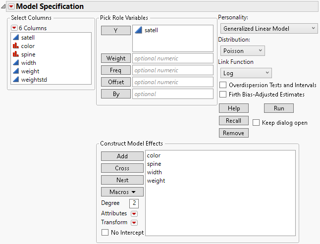

Launch the Generalized Linear Model personality by selecting Analyze > Fit Model, entering one or more columns for Y, and selecting Generalized Linear Model from the Personality menu.
Figure 13.4 Fit Model Launch Window with Generalized Linear Model Selected

When you select Generalized Linear Model for Personality, the Fit Model launch window changes to include additional options. The following additional options are available in the Generalized Linear Model personality:
Distribution
Specifies a probability distribution for the response variable. See Statistical Details for Generalized Linear Model Construction.
Link Function
Specifies a link function that relates the linear model to the response variable. See Statistical Details for Generalized Linear Model Construction.
Power
(Appears only when Power is specified for the Link Function option.) Specifies the parameter for the Power link function. See Statistical Details for Generalized Linear Model Construction.
