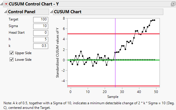

By default, the CUSUM Control Chart platform produces a report that contains a parameter control panel and a CUSUM chart.
• Control Panel for CUSUM Control Chart
• CUSUM Chart Report
Figure 10.5 CUSUM Control Chart Report
