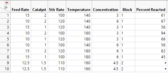

6. Click Add Centerpoints, enter 2, and then click OK.
7. Click Make Table.
Figure 6.15 Design with Two Center Points Added
