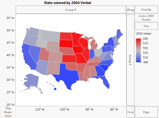

The Graph Builder platform lets you adds color to create choropleth maps. A choropleth map shows statistical differences in a geographic area while maintaining the proportion of the statistical variable.
Drag a column containing geographic place-names, like countries, regions, states, or provinces, into the Map Shape zone and create a map. Then drag a column to the Color zone to color the map by that column. The categorical or continuous color theme selected in your Preferences is applied to each shape.
Figure 12.7 Example of SAT.jmp After Dragging 2004 Verbal to ColorĀ
