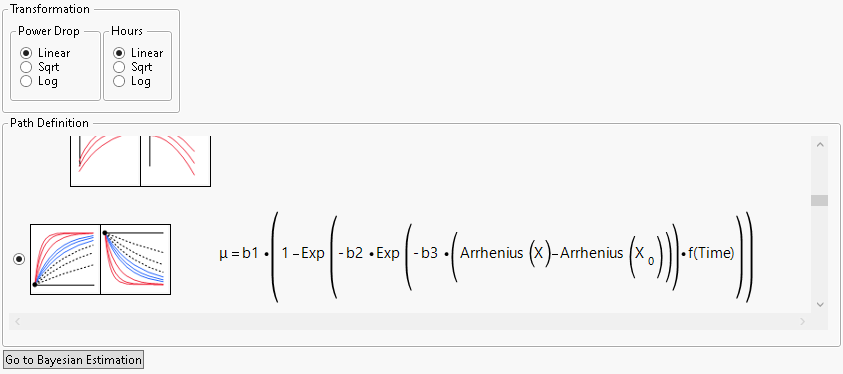

10. In the Path Definition panel, select the seventh model.
Figure 8.12 Selected Path Definition Model

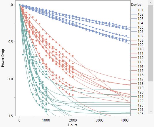

Figure 8.13 Initial Model Specification
Figure 8.14 Initial Model Plot
Initial Model Plot

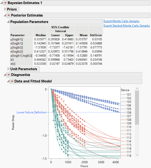

15. Click Go to Bayesian Estimation.
16. Click Fit Model.
Figure 8.15 Posterior Estimates and Diagnostics
The Posterior Estimates report shows the results of the MCMC procedure. Use the buttons to the right of the table to view all the MCMC samples in a data table. The Diagnostics report shows the original data values along with curves for the fitted model.

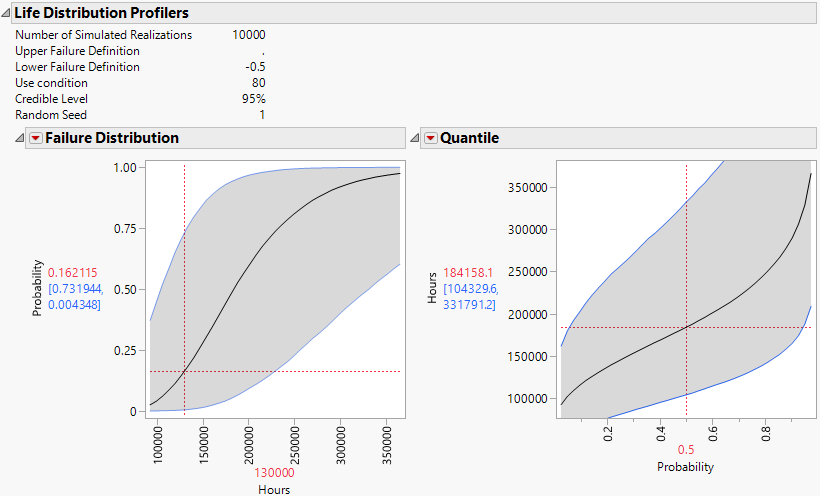

17. In the Failure Distribution profiler, type 130000 for Hours.
Figure 8.16 Life Distribution Profilers
The Failure Distribution profiler shows that at a use condition of 80 degrees Celsius, the estimated failure rate at 130,000 hours is approximately 0.16 with a 95% credible interval of 0.004 to 0.732.
