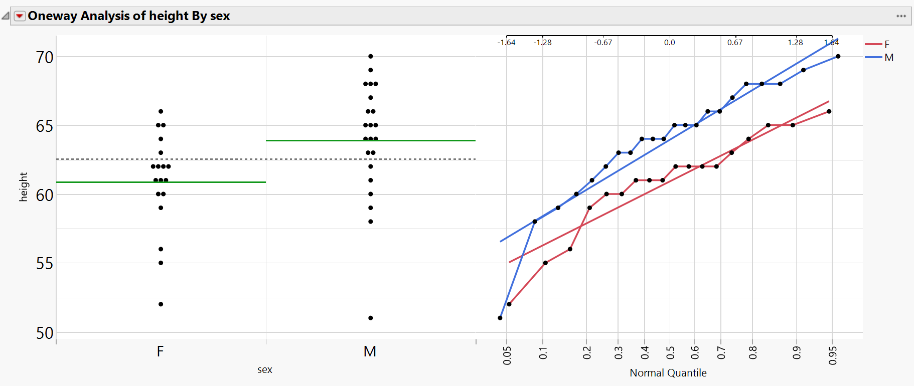

In this example, you use a Platform Preset to create a report ready for presentations or sharing with your team and then save the report as a graphic.
Create the Report and apply the Preset
1. Select Help > Sample Data Folder and open Big Class.jmp.
2. Select the Oneway green arrow.
3. Click the Preset button in the Oneway Analysis of height By sex menu bar.
4. Select Sample Presets > Presentation Normality.
Figure 10.7 Example of a Platform Preset for Presentations
