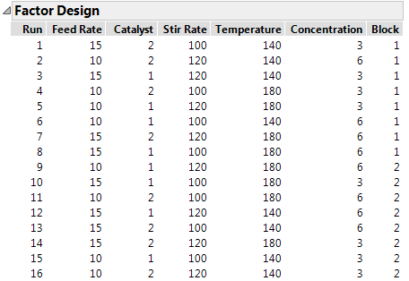

Figure 6.16 Foldover Design on All Factors
8. Click Make Table.
Each run in Block 2 can be obtained by changing the factor levels (from low to high or from high to low) of a run from Block 1.
