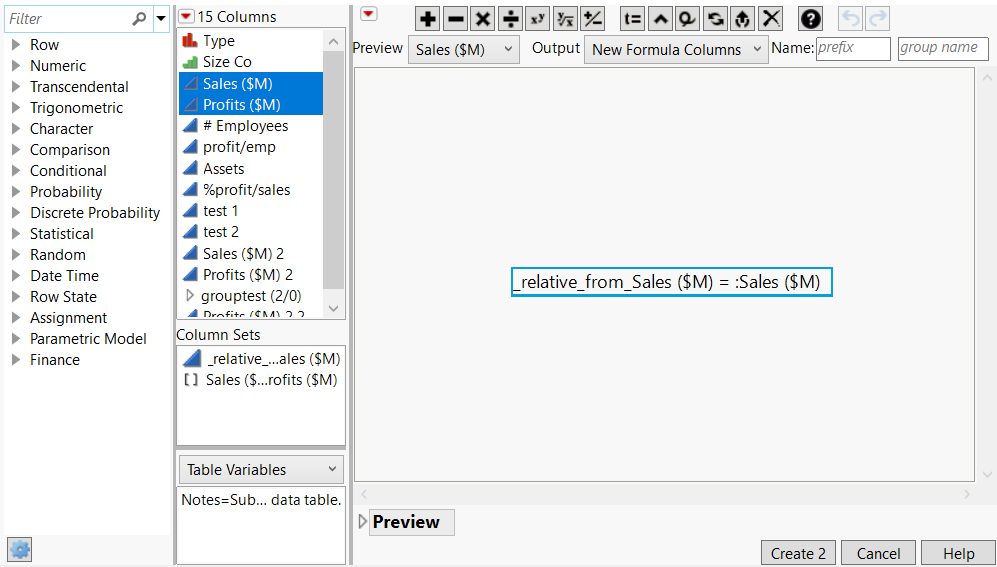

Figure 4.43 Creating Formula Columns with the Formula Editor

Use the Column Sets panel to work with sets of columns. This panel is available by opening the Formula Editor by selecting multiple columns. Use these sets as formula elements with functions that operate column-wise, like Sum and Median.
Two initial sets will be available when working with multiple columns.
The first set option, the floating column reference, is represented by the data type of the columns and prefixed by “_relative_from_”. This option treats each element of the set individually.
The second option, represented by the list icon Image shown here, is a list of the entire group. This option treats all elements of the set as one list.
