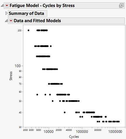

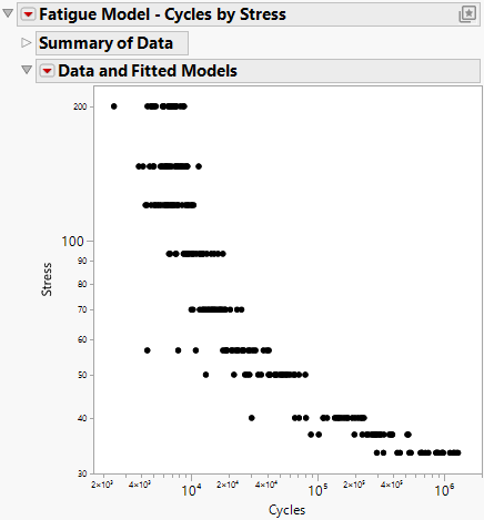

Figure 6.2 Fatigue Model Initial Report Window

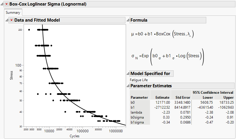

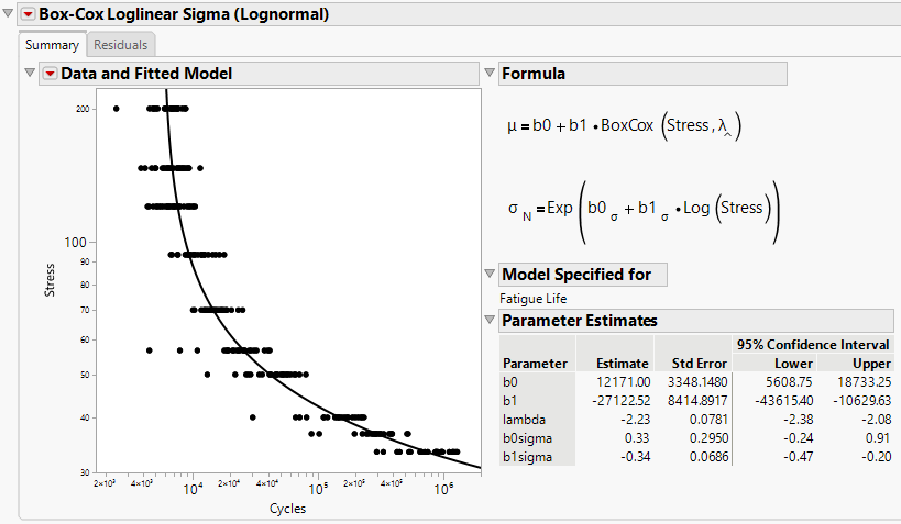

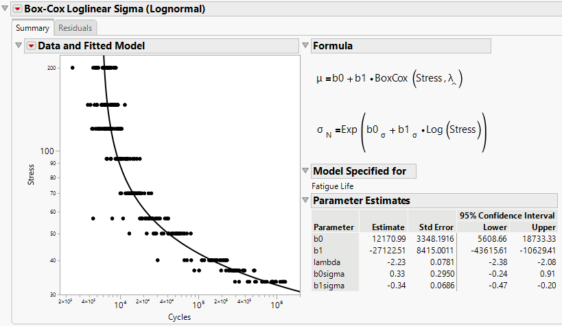

Figure 6.3 Box-Cox Loglinear Sigma (Lognormal) Model Report
A report appears for the fitted Box-Cox Loglinear Sigma (Lognormal) model. A curve for this model is also added to the Data and Fitted Models scatterplot at the top of the Fatigue Model report.
In this example, you fit a lognormal distribution to Cycles, conditional on Stress. The curve in the scatterplot in the model report represents the median of the distribution. At this point, you can explore this model further using options in the red triangle menu in the model report outline node or you can fit additional models for comparison using options in the Fatigue Model red triangle menu.
