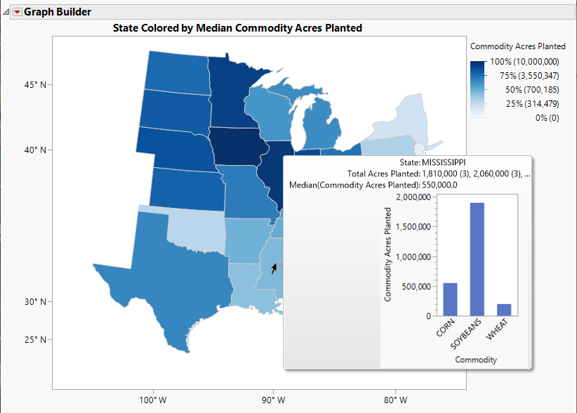

Figure 4.11 Map Showing Median Commodity Acres Planted

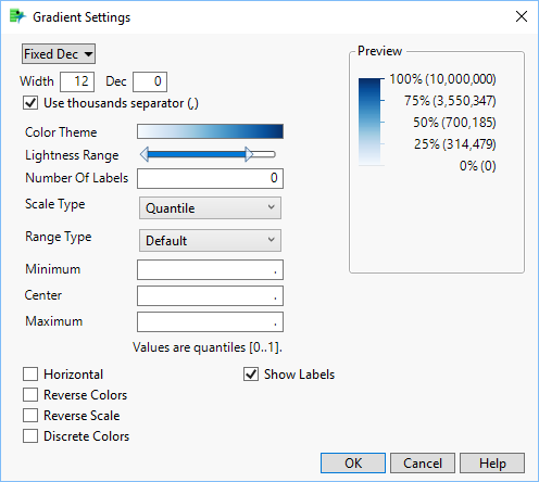

6. Customize the graph elements in the legend:
a. In the legend color bar, right-click and select Gradient.
b. Next to Width, enter 12.
c. Next to Color Theme, click the color bar. Under Sequential, click the 2nd option (white to blue) and then click OK.
d. From the Scale Type list, choose Quantile.
Figure 4.12 Completed Gradient Settings Window
e. Click OK.
7. Click the title above the graph and type State Colored by Median Commodity Acres Planted.
8. Right-click in the graph and select Hover Label > Bar.
This adds a bar chart hover graph. When you hover over a state, you can see the proportions of the commodities grown in that state in a bar chart.
Note: For more information about Hover Labels, see Customize Hover Labels in JMP Graphs in Using JMP.
9. Click Done.
10. Hover over a state (in this case, Mississippi).
Figure 4.13 Completed Map Colored by Median Commodity Acres Planted
The coloring on the map highlights the states with the highest number of acres of wheat, corn, and soybeans. The dark blue states are known as America’s Breadbasket. The hover graphs enable you to explore the proportions of the three crops grown in a state. This example shows that in Mississippi, soybeans are the prominent crop.
