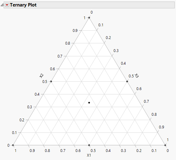

7. Select X1, X2, and X3 and click X, Plotting, and then click OK.
Figure 14.3 Ternary Plot for Simplex Centroid Design
For more information about ternary plots, see Ternary Plot Overview.
