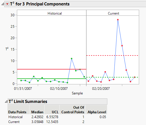

Figure 13.9 T2 Chart for Historical and Current Data
Note that there are two sets of limits. One set applies to the historical data. A second set of limits applies to the current data. For more information about how the historical data is used to calculate the two sets of limits, see Statistical Details for Limits.
