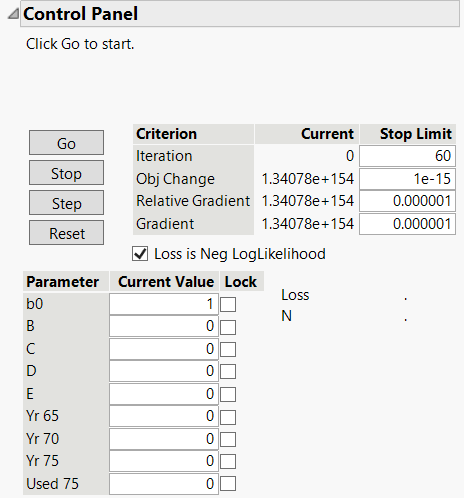

6. Set the Current Value (initial value) for b0 to 1, and the other parameters to 0.
Figure 15.18 Enter New Parameters
7. Click Go.

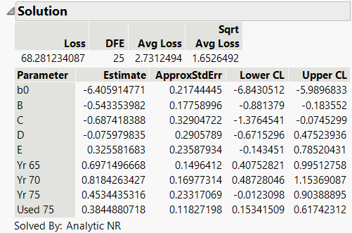

8. Click the Confidence Limits button.
The Solution report appears. The results include the parameter estimates and confidence intervals, and other summary statistics.
Figure 15.19 Solution Table for the Poisson Loss Example
Note: The standard errors, confidence intervals, and hypothesis tests are correct only if least squares estimation is done, or if maximum likelihood estimation is used with a proper negative log-likelihood.
