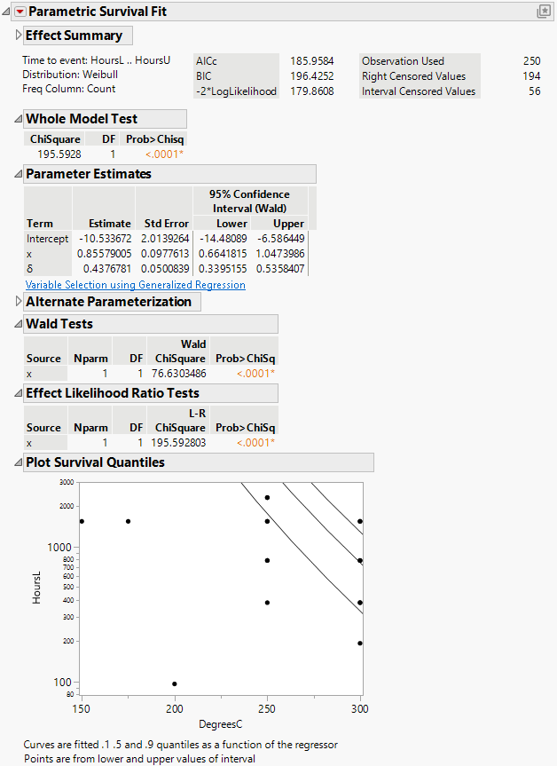

The data table in this example contains failures that were found to have happened between inspection intervals. The model uses two y-variables, which contain the upper and lower bounds on the failure times. Right-censored times are indicated with missing upper bounds.

Figure 15.12 ICDevice OutputĀ
ICDevice Output
The resulting regression shows a plot of time by degrees.
