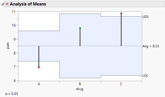

6. Click the Oneway Analysis red triangle and select Analysis of Means Methods > ANOM.
Figure 6.11 Analysis of Means Decision Chart
From the ANOM decision chart, notice that the means for drug A and C are statistically different from the overall mean. The drug A mean is lower and the drug C mean is higher. Note the decision limits for the drug types are not the same, due to different sample sizes.
