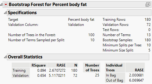

Figure 5.5 Overall StatisticsĀ
Overall Statistics
The Overall Statistics report shows that the Validation RSquare is 0.654.

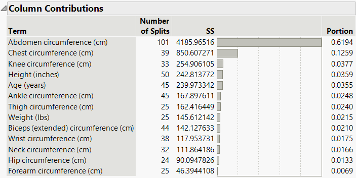

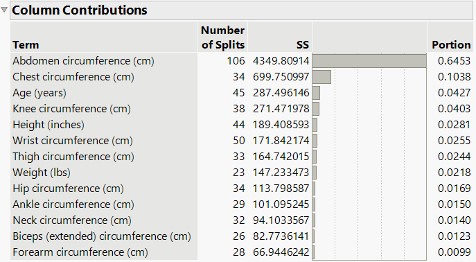

9. Click the red triangle next to Bootstrap Forest for Percent body fat and select Column Contributions.
Figure 5.6 Column ContributionsĀ
The Column Contributions report suggests that Abdomen circumference (cm), Chest circumference (cm), and Age (years) are the strongest predictors for Percent body fat.
