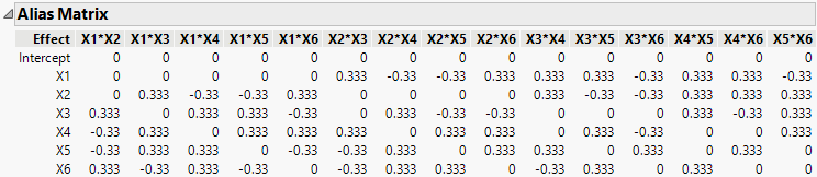

6. Open the Alias Terms section to confirm that all two-factor interactions are in the Alias Terms list.
7. Open the Alias Matrix section.
Figure 17.37 Alias Matrix for Plackett-Burman Design
For each model term listed in the Effect column, the entry in that row for a given column indicates the degree to which the alias term affects the parameter estimate corresponding to the model term.

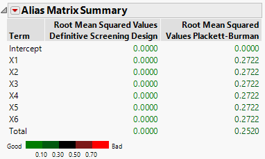

Figure 17.38 Alias Matrix Summary for Two Designs
To obtain the Alias Matrix Summary entry corresponding to X1, square the terms in the row for X1 in the Alias Matrix, average these, and take the square root. You obtain 0.2722.
