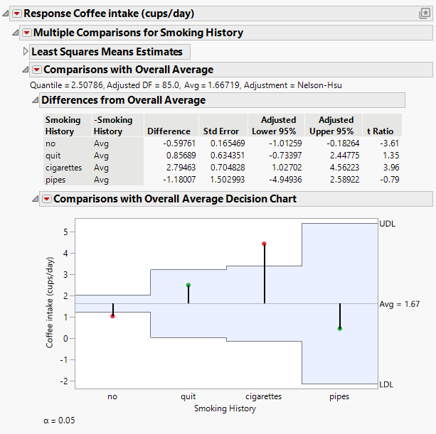

Figure 4.45 Comparisons with Overall Average for RatingsĀ
The results in the Comparisons with Overall Average report indicate that the least squares means for non-smokers and cigarette smokers differ significantly from the overall average in terms of coffee intake.
