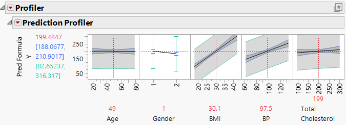

4. Click the Prediction Profiler red triangle and select Prediction Intervals.
Figure 3.39 Profiler with Confidence and Prediction Intervals
A prediction profiler is shown with confidence and prediction intervals constructed using the limits in the hidden columns. The confidence intervals are shown in blue, and the prediction intervals are shown in green. Since the prediction intervals are for an individual observation, they include more variation and are wider than the confidence intervals.
