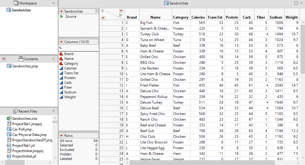

5. Select File > Save.
6. Make sure Project Contents is selected.
7. Change the file name to Sandwiches.jmp and click Save.
Figure 11.27 Project with Sandwiches Data Imported

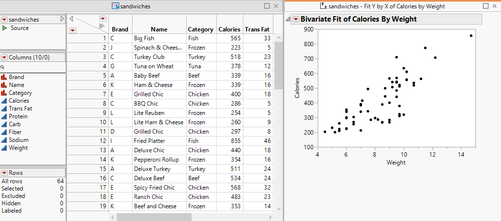

12. Drag the Sandwiches - Fit Y by X tab to the right and drop it into the Dock right zone.
Tip: To show the entire report, you can drag the line between the data table and the report to the left.
Figure 11.28 Fit Y by X (Bivariate) Report Docked at Right

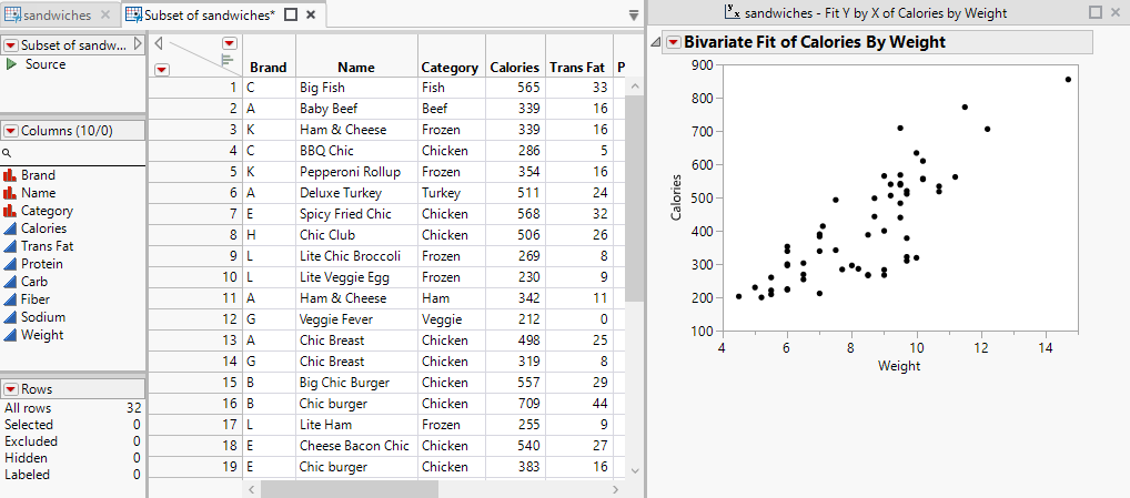

13. Select Tables > Subset.
14. Under Rows, select Random: sampling rate 0.5.
15. Click OK.
Figure 11.29 Project with Unsaved Subset Table
