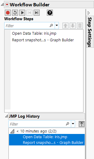

7. Select File > New > Workflow.
In the JMP Log History, all the steps you have performed since you opened your JMP session are captured.
8. Select the Graph Builder steps that you want to add to your workflow.
Figure 13.7 Selecting Steps in Workflow BuilderĀ
9. Click Image shown here to move the steps up.
10. Click Image shown here to test the workflow.
