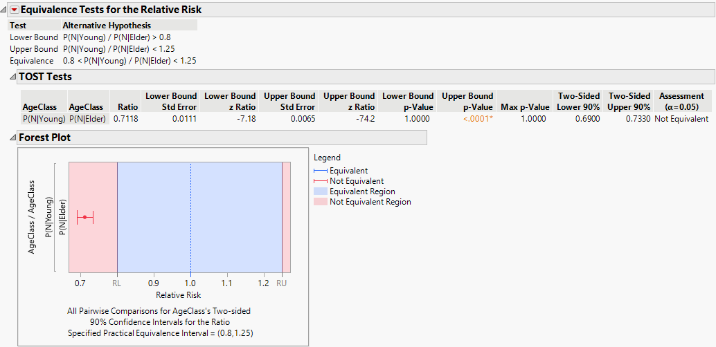

Figure 7.17 Equivalence Test for Relative RiskĀ
The relative risk of not filing a claim for young drivers versus elder drivers is 0.7118. From the two one-sided tests (TOST) equivalence test procedure, you cannot conclude that these groups are equivalent in their rates of filing claims.
